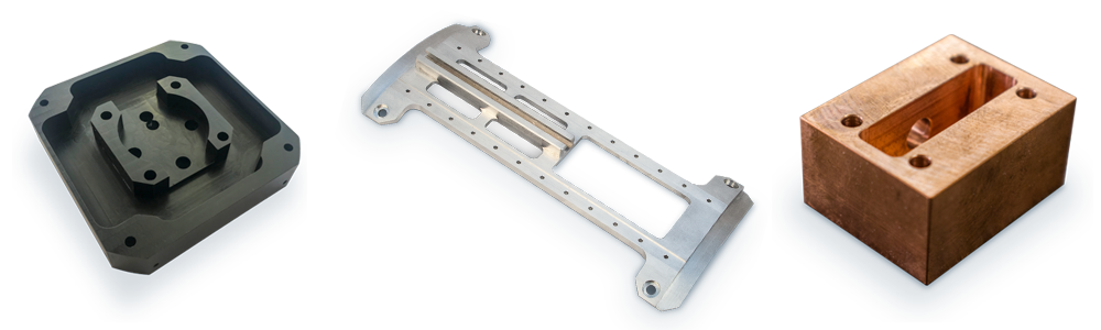

CNC Milling
CNC Milling uses a rotating cutting tool, such as an endmill, to remove material from a stationary workpiece. The cutting tool moves along multiple axes (typically 3, 4, or 5-axis) to create complex shapes, features, and contours.
Best Suited For:
- Complex parts that require features on multiple faces, such as pockets, slots, holes, and intricate surface contours.
- Prismatic parts (block-like shapes).
- Parts where internal or external cylindrical (turned) features are not the dominant characteristic.

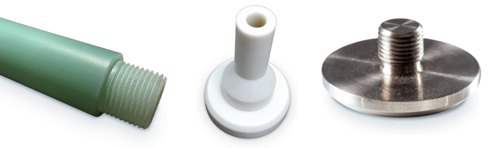

CNC Turning
CNC Turning involves mounting the workpiece in a chuck and spinning it rapidly while a stationary cutting tool is fed into the part's circumference. Material is removed to create cylindrical features. This is often done using a CNC lathe.
Best Suited For:
- Parts with rotational symmetry, such as shafts, pins, bushings, fasteners, and simple cylindrical profiles.
- Threaded cylindrical components where the thread runs along the central axis (e.g., bolts, screws, threaded rods).
- Quick production of round components.

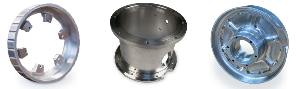

CNC Mill and Turning Combo
Also known as CNC Mill-Turn, this sub-process applies to parts that require a significant combination of rotational (turned) features and non-rotational (milled) features. While these parts can be efficiently machined on single, multi-tasking machines with live tooling, they may also be produced by transferring the part between separate CNC turning and CNC milling setups. Selecting this option highlights that the part requires both types of subtractive machining to be completed.
Best Suited For:
- Complex parts that require both turning (cylindrical features) and milling (non-symmetrical features like flats, cross-holes, and pockets) on the same component.
- Complex shafts or spindles that require both round bodies (turned) and features like keyways, gear teeth, or cross-holes (milled).
- Parts requiring off-axis features (e.g., holes drilled perpendicular to the main cylindrical body).
- Components with flats or hex features milled onto a round body (e.g., wrench flats on a custom bolt head).

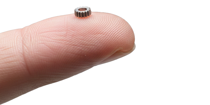

Micro Machining
Micro Machining refers to manufacturing parts or features with dimensions in the micrometer range (e.g., typically <1 mm). This process uses extremely small tools and high-precision, high-speed spindles on specialized machines to achieve micron-level tolerances.
Best Suited For:
- Tiny parts required in medical, aerospace, and electronics industries, such as surgical instruments, standoffs, and fuel injectors.
- Micro-gears for small-scale mechanical systems, such as those found in watches and small motors.
- Parts with sub-millimeter features and tolerances tighter than ±0.001".

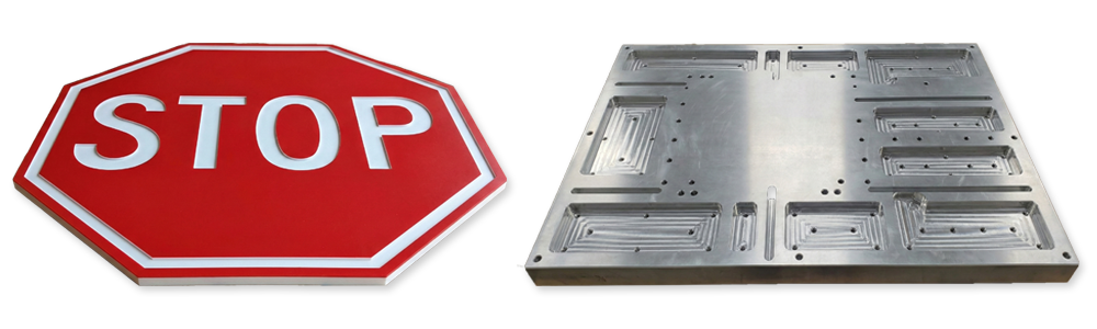

CNC Routing
CNC Routing is a high-efficiency subtractive process using large, gantry-style machines optimized for cutting parts from sheet materials. Unlike milling, which often involves facing the material to achieve a specific thickness, routing is designed to preserve the original top and bottom surfaces of the stock material. The machine cuts only the necessary features, such as outlines, pockets, and holes, allowing for significantly faster run times and lower costs. This method is ideal for industrial applications where the stock material's factory finish and thickness meet the requirements of your final part.
Best Suited For:
- Cost-effective industrial components where the top and bottom surfaces do not need machining (e.g., aluminum tooling plates, fixture bases, and brackets).
- Optically clear panels (e.g., Acrylic/Polycarbonate windows) where preserving the factory face is critical to maintain transparency without the need for post-polishing.
- Multi-layer material applications, such as routed signs made from ColorCore® or similar HDPE, where precise depth control reveals contrasting internal colors.
- Large, flat parts that require simple features (pockets, holes, profiles) and would be cost-prohibitive to produce on a standard CNC mill.
